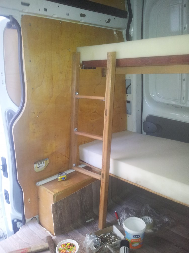

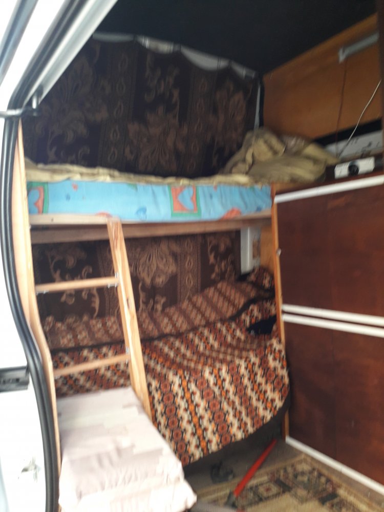

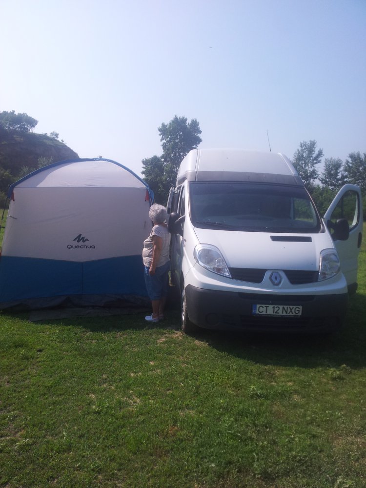

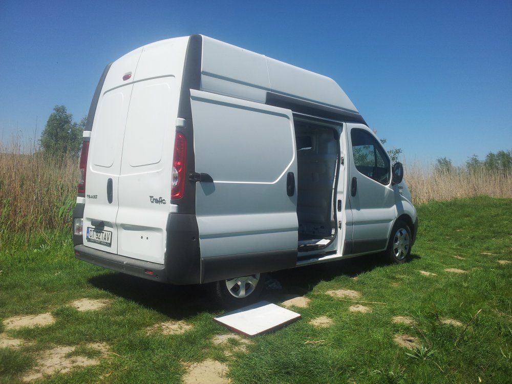

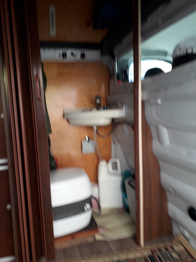

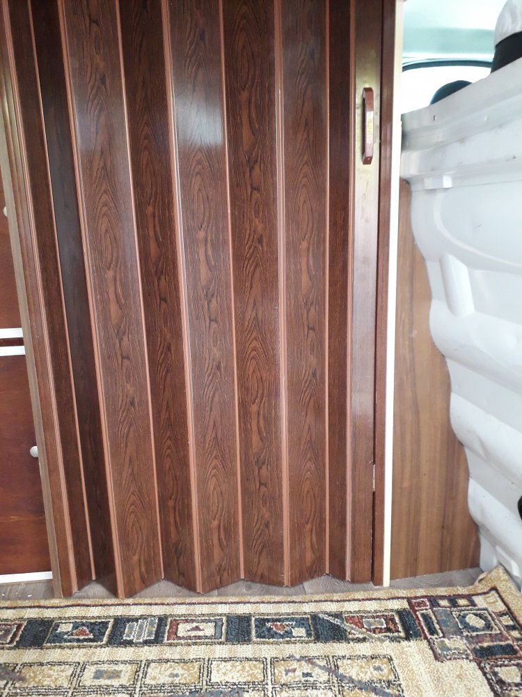

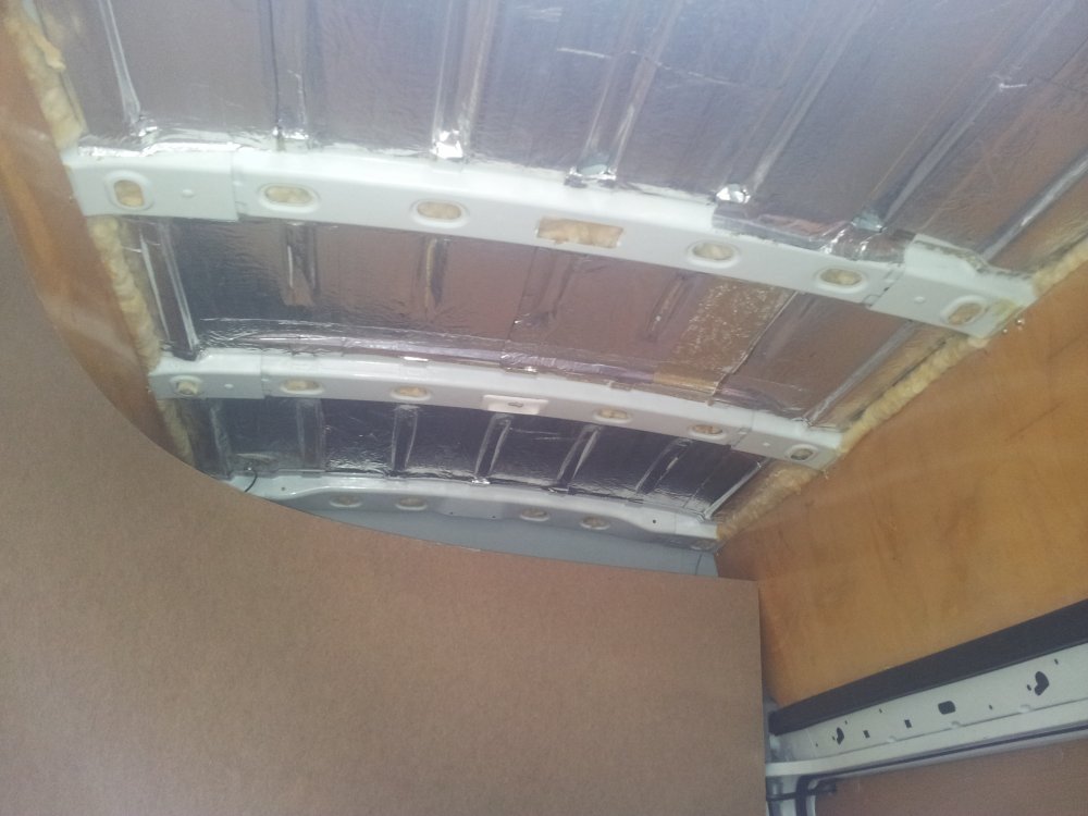

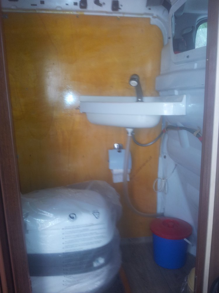

Anul trecut am renuntat la rulota, dupa 12 ani, si am cumparat o autoutilitara Renault Trafic si m-am apucat de amenajare.
2 paturi suprapuse, dulap, toaleta cu chiuveta si pompa pt.apa murdara care o colectez in bidon.
La Galati am montat Webasto original[ cu garantie 2 ani].
In toamna am facut ITP-ul fara probleme.Daca nu demontezi panoul despartitor si nu modifici caroseria nu ai probleme.Am trecut prin filtre ale politiei in timpul pestei porcine fara comentarii.
Greutatea nu ai cum sa o depasesti cu ceea ce vrei sa montezi.Masina ramane N1.
Am parcat peste tot unde este permisa parcare autoturismelor.In concluzie nu va faceti probleme.Bafta.5c694b5a28f54_cocedii012.jpg.ca83a5b15bd3b61b120287fd7170a9d1.jpg5c694a81ebec4_cocedii024.thumb.jpg.2f25979ba335b4a753aaa4cc0edf83dc.jpg5c0be2c14ba0b_imaginilemele012.thumb.jpg.d58df24f87dd082cb3c873a06c8faf7f.jpg5c4492e46911a_imaginilemele027.thumb.jpg.b69155c574fef3a1da93b469351b6f99.jpg5bf1323e5aac7_rulota061.thumb.jpg.f9dcdb3cf9339a0dd93a878eedfedab4.jpg5c0be29ef3bd0_imaginilemele007.thumb.jpg.e37e483562bda9163fac87bf449c4fa0.jpg5c0be2d6a6516_imaginilemele010.thumb.jpg.f27133d84bf262dac0514d030a4afcf6.jpg5c0be29ef3bd0_imaginilemele007.thumb.jpg.e37e483562bda9163fac87bf449c4fa0.jpg101.jpg.22261040cae56ab46b86c01f5c39a476.jpg
